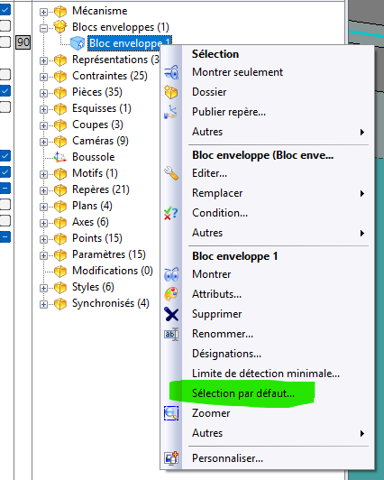

i dont know why the default selection command doesn’t appear in your version (i’m using a 7.16 version with the -a startup argument and it appear on mine) you might have a personalized menu that hides it.

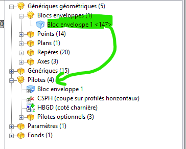

maybe you need to generate a family and use the block as a pilot first( entirely speculative)

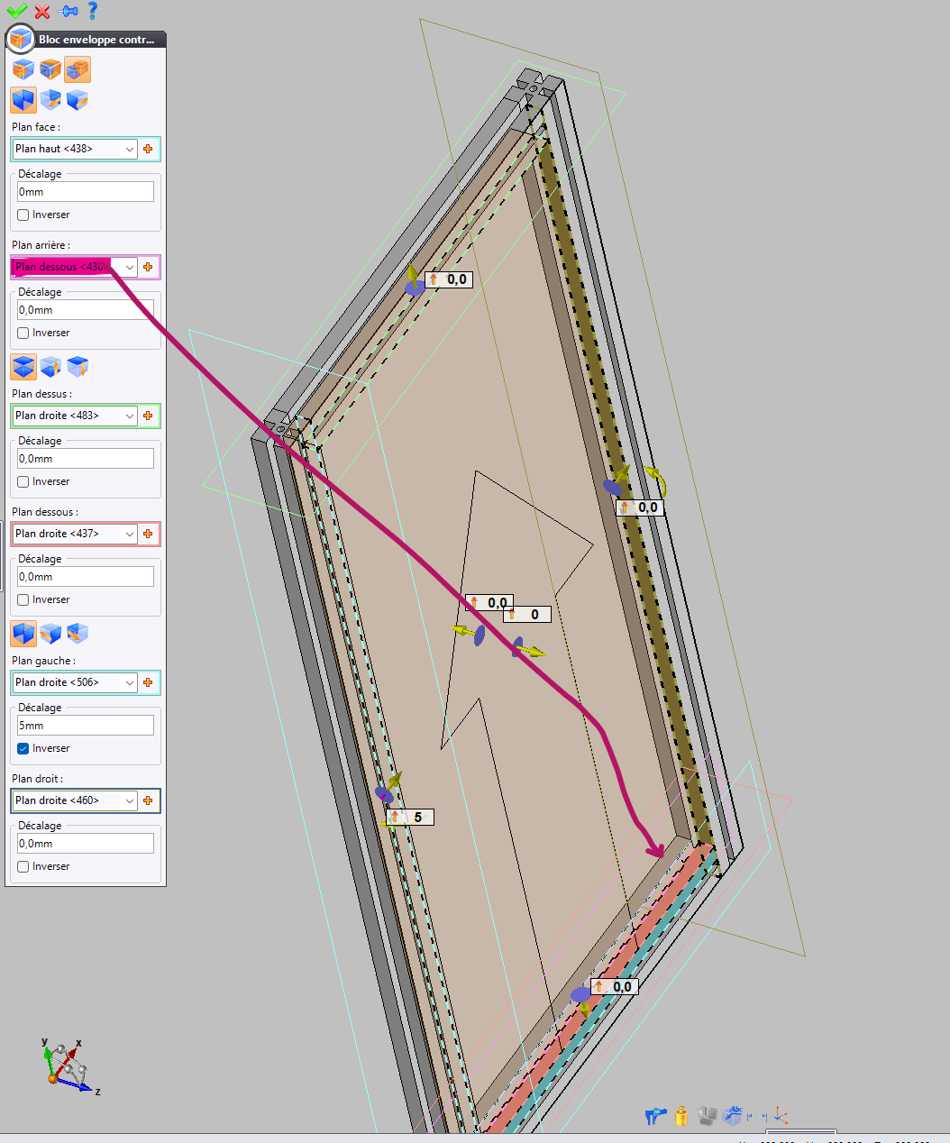

to create a constrained block enveloppe you need to already have some shapes/planes/ reference frame in your assembly
i use it mostly to force a block the way i want if it doesn’t generate properly
on the example below i want the block to generate past the groove of the profile so i have t o select the back and front plane of the block to generate properly. it’s not something i would usually do since all my component are created using only the front plane of the block
